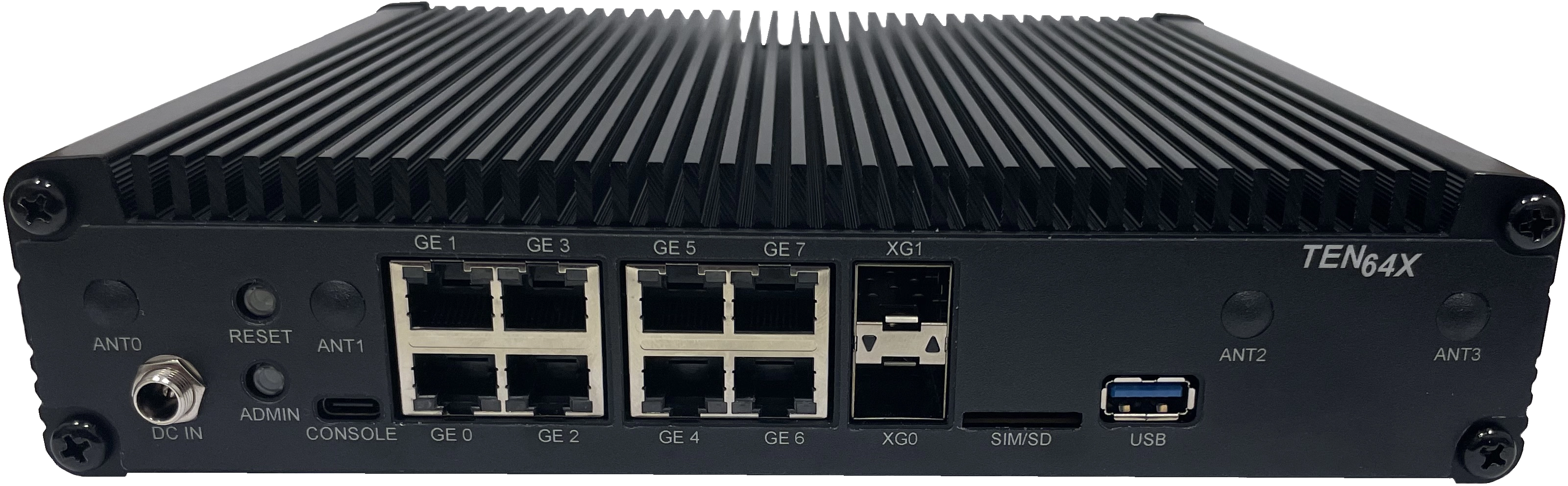

Ten64 XE Hardend appliance features NXP’s Second Generation Data Path Accelerator Architecture (DPAA2) which includes the 28Gbps Wire-Rate IO Processor complex (WR-IOP) with 8 Gigabit Ethernet ports + 2 x 10G SFP+, the NXP SEC accelerator engine and the Advanced IO Processor (AIOP) which can offload network processing functions from the general purpose CPU cores. With DPAA2 and IO-MMU capabilities, network ports and other hardware can be passed through to virtualized network functions (VNF’s) securely. With its higher temperature range, the device allows you to bring serious computing power to the edge
CPU | NXP Layerscape LS1088A 8x A53 Cores DPAA2 Security Engine (SEC) |
External | 8x Ethernet 10/100/1000 Mbps 2x Ethernet 10Gbps (SFP+) 2x USB 3.0 Combo SD/SIM card slot USB Console port Optional IO Ports |
Internal | 2x MiniPCIe M.2 5G/LTE slot (52/42mm) with dual SIM M.2 Key-M slot for SSD or VDSL module USB 3.0 GPIO Header ITX Header |
Memory | DDR4 64bit SO-DIMM with ECC 8MB NOR Flash 256MB NAND Flash |
Onboard Peripherals | Real Time Clock (RTC) Temperature Sensors (CPU and PCB) Voltage Monitor : Vin, 5V, 3.3V, CPU,DDR Current Monitor : 5V, 3.3V, CPU, WiFi |
PSU | 12VDC, 5A / 2.5mm barrel |
Temp Range | 0 to 70°C |
Linux Kernel | 5.0 and later |
Linux Distributions | Debian, SuSE Enterprise Linux*, OpenWRT BSP available for other distributions on request |
DSL Support | ADSL/2/2+ Annex A/M VDSL2 Vectoring Profiles 8,12,17a,35b |
Unit | 200 x 200 x 45mm |
Package | 245 x 235 x 115mm |
